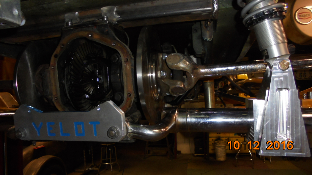

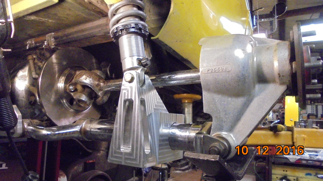

Now you see what it is..............Darr does some real nice work..........Most of the time your shock mount will be toward the bottom of the axle but I did not want to remove the body to change the upper mounts so just a little bit of machining........Well not just a little but some............ :)! :)! :)! :)! :)! :)! :)! :)! :)! :)! :)! :)! :)!
The inside of the third member looks great so a new gasket and some RTV will be done.....Gona be driving it soon.......... :)! :)! :)! :)! :)!

Looking good :)! :)! What spring rate are running?
Posts: 5049
Re: New photos and sometimes old photos......
The same I was running 200 Lbs......May have to change that now....... :)! :)! :)! :)! :)! :)! :)!

job done, now back to making Alum-A-T run again

Thank You Bill,,,,,,,,,Great job and if I can help with anything let me know........I like them..Now for some tires & check the coilovers out tomorrow........... :)! :)! :)! :)! :)! :)! :)! :)! :)! :)! :)!

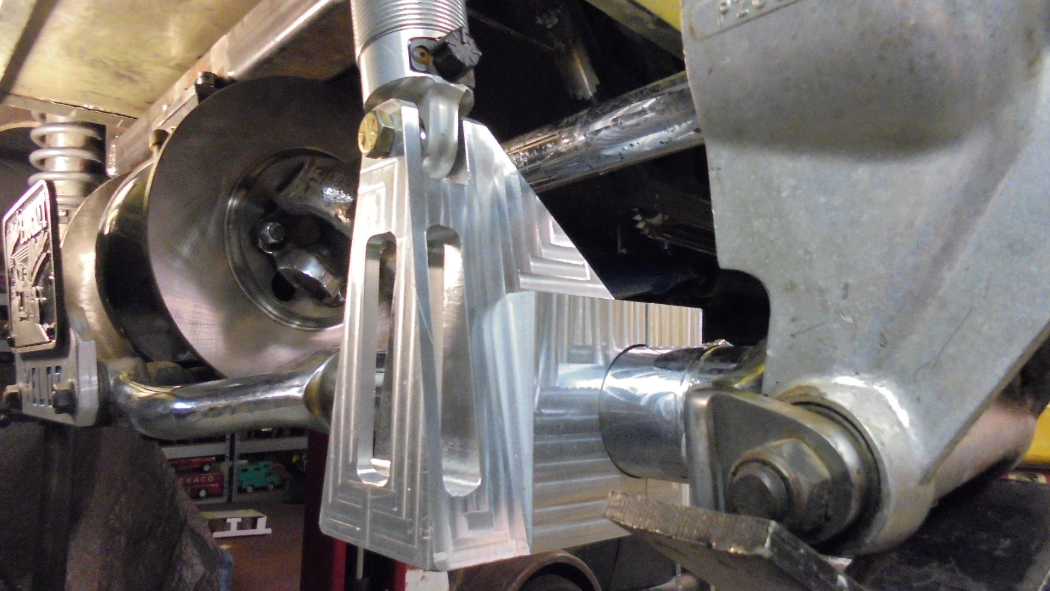

All those aluminum scraps seem to find a place to be useful!

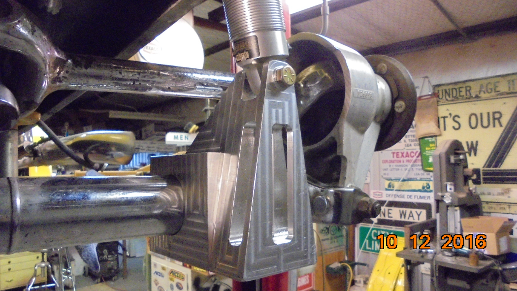

The first one look pretty good but the next ones I don't think it is supposed to look this way........... :oops: :oops: :oops: :oops: :oops: :oops: :oops: :oops: :oops: :oops: :oops:
Sorry for the fuzzy photos...
Needs a different set of springs I think.......... :roll: :roll: :roll: :roll: :roll: :roll: :roll:
Hey Mike, Looks like maybe you will have some bad tire wear!
I am running 4 shocks @ 175# each. For what it's worth.
