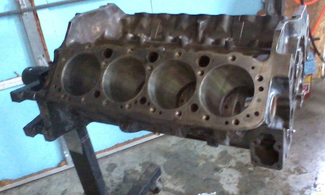

This is where a network of friends can come in handy. Somebody knows somebody somewhere that has an old 350 (or any other small block) lying around that's probably rebuildable. Check the local auto parts stores and ask around. Mine came from a friend's tool shed - it was free if I would haul it away! And after cleaning up, all it needed was a good cylinder hone. A rebuild kit from Northern Auto Parts and I was in business. And don't be afraid of a 305, or even 307. They can be coaxed into producing enough HP to move a bucket down the road smartly.

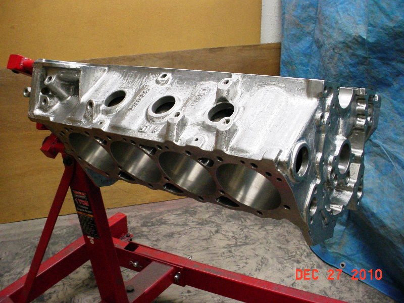

I have a 4 bolt main, 350 cuin SBC that has been bored .060 inches and is ready for the
pistons to be fitted. Block number is 3970010.
There is a down side, when I had the cylinder wall thickness sonic tested. The wall
thickness got as low as .064 inches, but at least it's not on the thrust face. You can
see the results below.
On the plus side is I have gone over the block on the outside (maybe inside, can't remember)
with an abrasive and smoothed out the casting roughness.
THIS IS NOT THE ACTUAL BLOCK, BUT WOULD LOOK VERY SIMILAR.

Two points. 1) Being bored .060 means there is no room for further work. 2) I don't know what the wall thickness should be but .064 sounds a bit thin.
I know these engines are 'old' and finding a block that has not already been bored is unlikely. I'd like to stay no more than .030 over so if needed I can go to .060 over at some point in the future.
