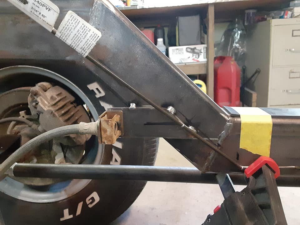

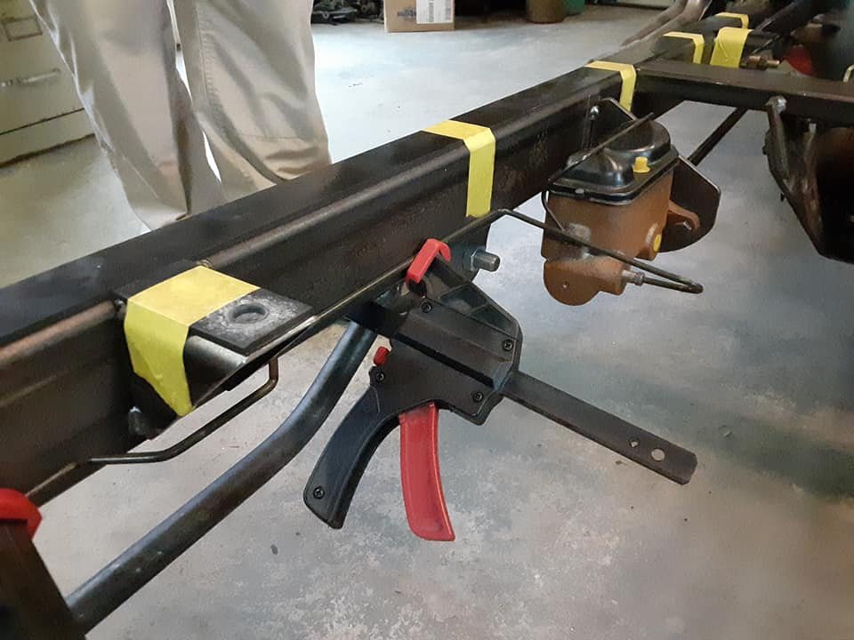

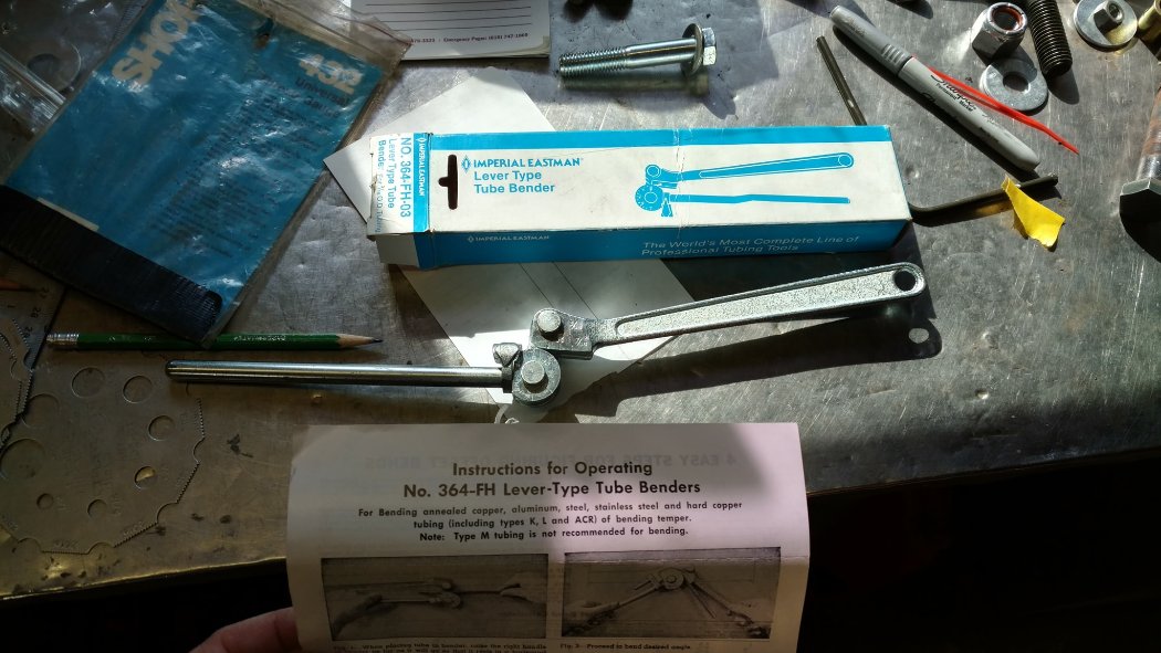

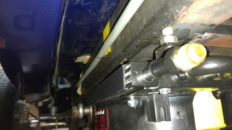

Jarrett posts on fb: "Brake line day!! Me and dad gonna be professionals when we done!"
Re: Jarrett's 27 roadster
Very nice guys :)! :)! very neat and good bends, I suggest when you hang the line use the straps that are rubber lined. But you know that! :lol:

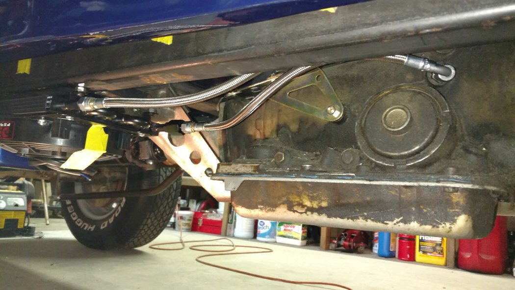

Cory posts on fb: "Fuel line may get run on outside of frame up in void. Transmission line measurements turned in and should have them by this evening."
Nice work guys!
Posts: 5146

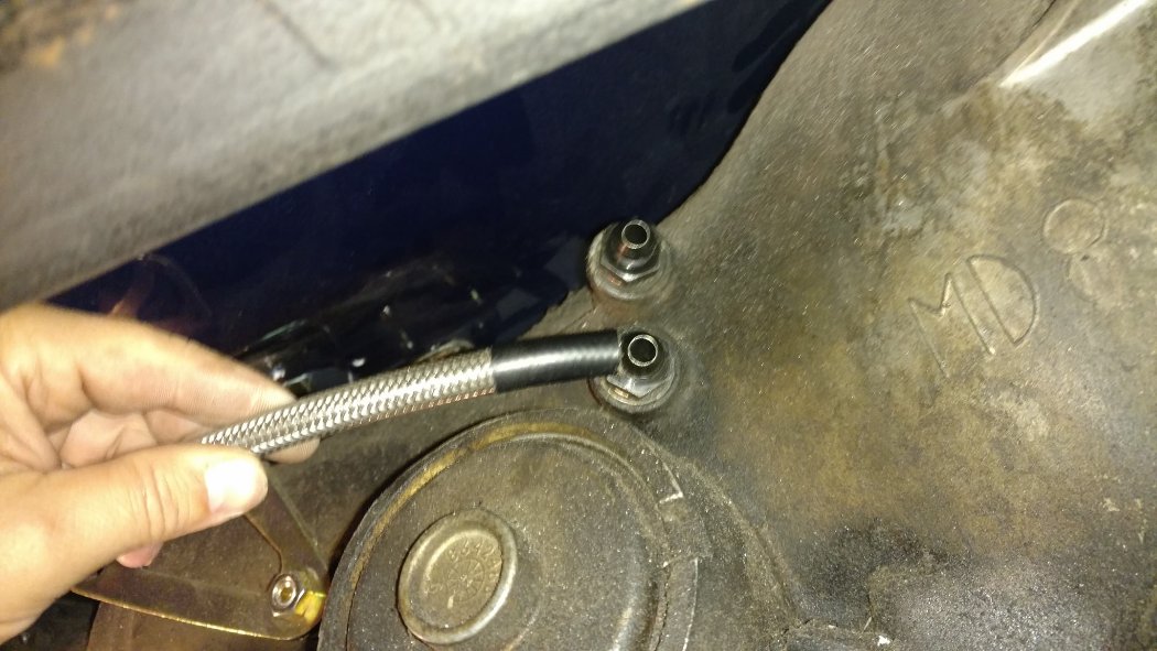

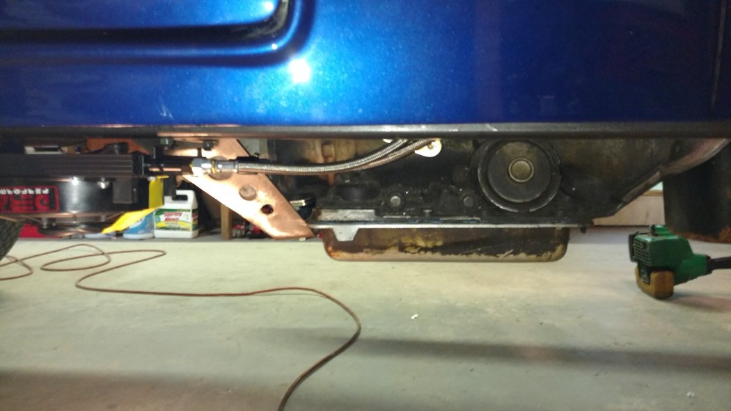

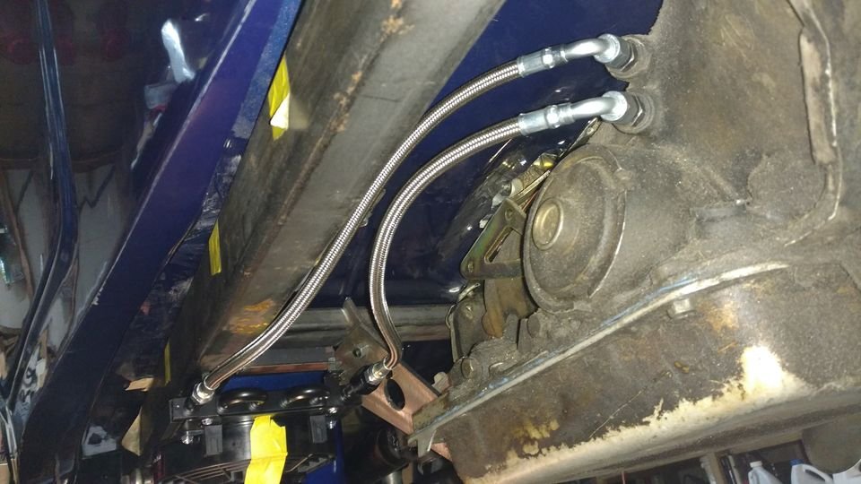

Cory posts on fb:"Transmission lines done. Need a double AN line separator to finish the job. Thanks Robert Forsythe"

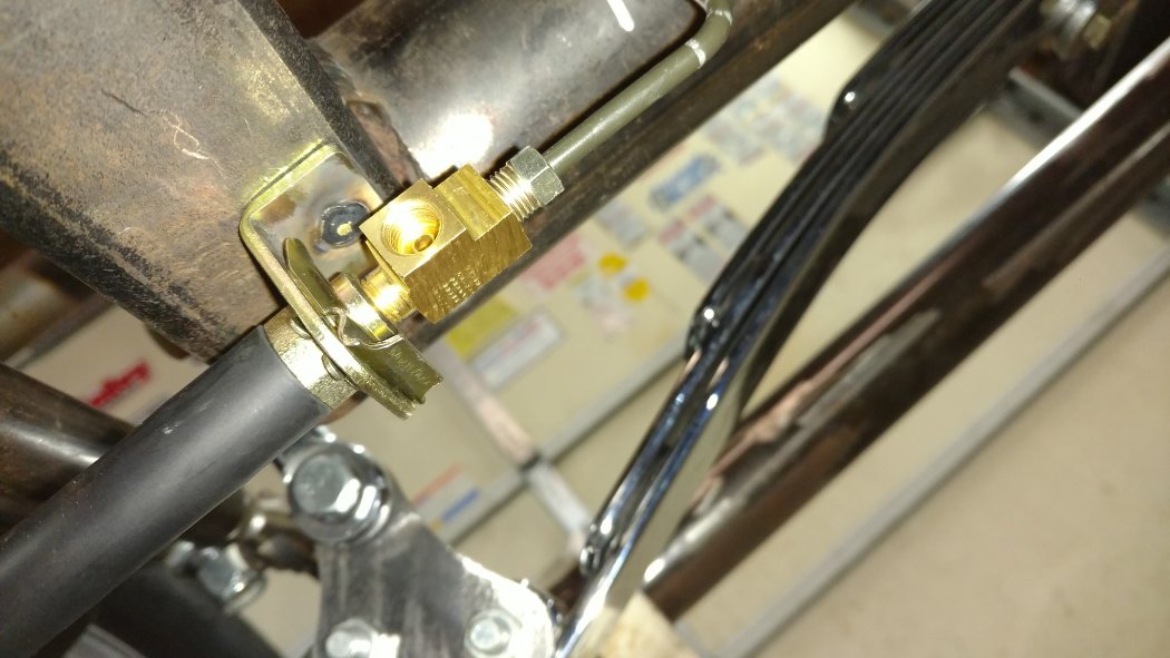

Cory posts on fb: "Another brake line plumbed. Just need to attach to master cylinder and plumbing for brakes is done!"

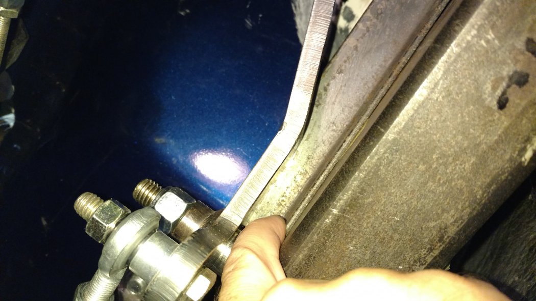

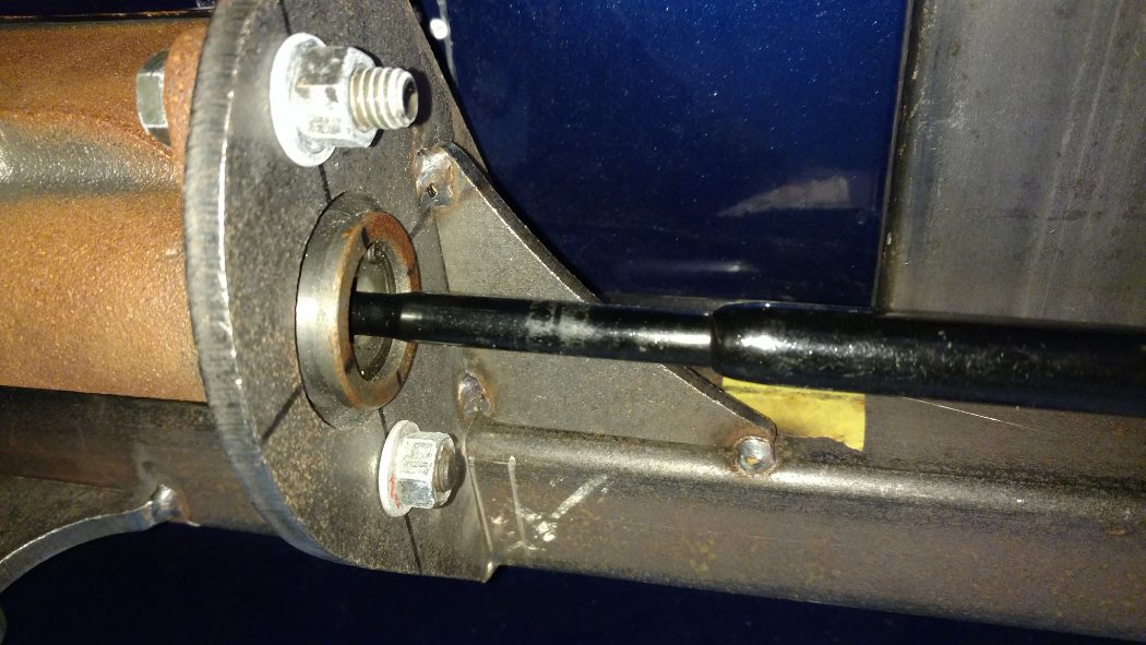

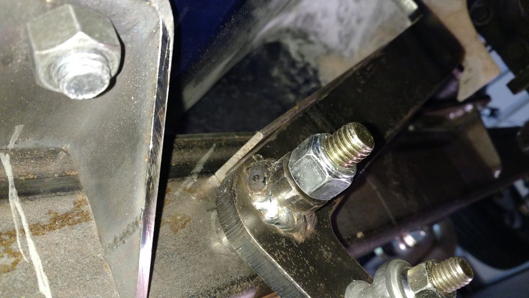

Cory posts on fb:
Need to build pedal stop so brake rod can't come out of master cylinder. Gonna use camaro brake light switch with cruise control to work lights and transmission converter lock up. Any pictures or ideas cause I'm thinking.
