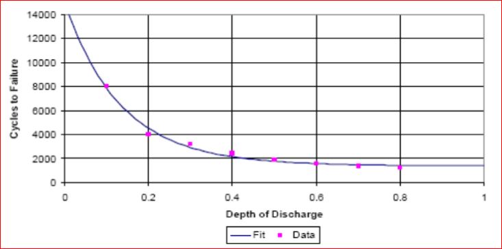

Well it's certainly old enough at 4 years to be having trouble. Temperature, depth
of discharge and time are major factors concerning battery life.
http://www.sciencedirect.com/science/ar ... 5396023713
http://www.power-thru.com/documents/The ... 0Paper.pdf
[attachment=0]DischargeCyclesOfLeadAcidBattery.JPG[/attachment]
A good battery should easily stay charged for 3 days obviously.
It will be interesting to see if the alternator is putting out enough to charge the battery
while also carrying any load that's put on the system.

- DischargeCyclesOfLeadAcidBattery.JPG (39.79 KiB) Viewed 355 times
