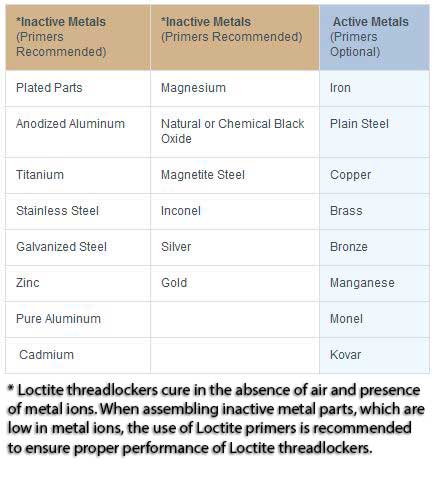

I thought it was just a matter of picking a number, put a few drops on the threads and tighten,
but that's not the case. Loctite dries in the absence of air and in the presence of metal ions. Or
what's referred to as an Active Metal.
OK, so what metals are active and which ones are inactive?
Loctite Active-Inactive Metals.JPG (29.53 KiB) Viewed 1248 times
Sure wish it would put the image here, like it's suppose to!
So when I've been using SS bolts into aluminum, I wasn't getting Loctite to fully cure.

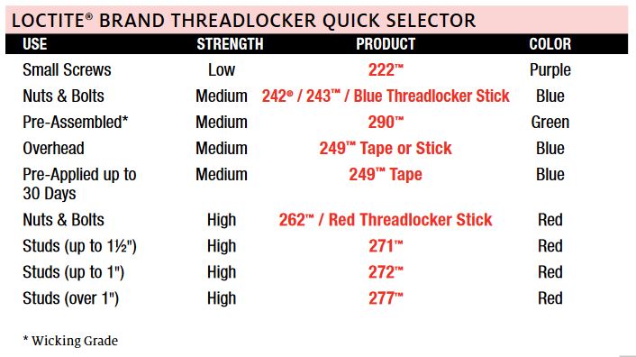

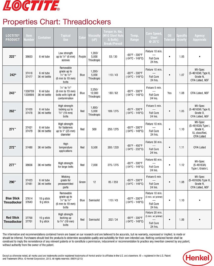

There are many different versions of Loctite threadlocker, the application charts below should be of some help.
Loctite Application Chart.JPG (56.43 KiB) Viewed 1248 times
Loctite Spec Chart.jpg (196.54 KiB) Viewed 1248 times

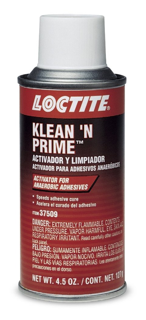

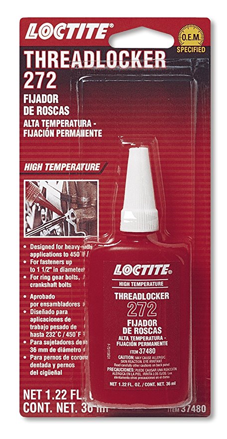

Loctite 272.jpg (114.5 KiB) Viewed 1229 times
How is the stick threadlocker and primer selling? It looks to be the Cats-Meow !!!
