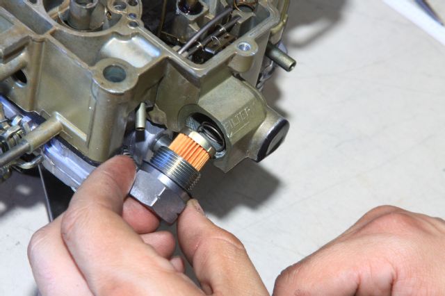

You don't say what kind of carburetor you have, some of them will have a filter internal
to the carb.
to the carb.
