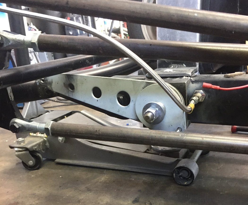

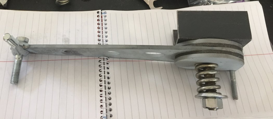

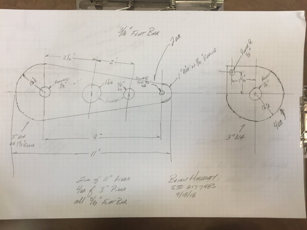

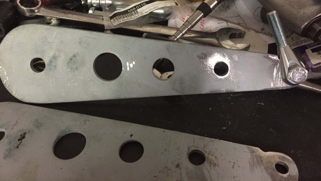

Was an easy project for a Saturday. Thank God the frame is rattle canned and not powder coated. I can't plan far enough ahead to get all the fab done before powder coating. Hope you guys enjoyed looking at this. And if someone is considering it, I'll say GO FOR IT, it was easy and fairly inexpensive. You can always wish you just gone tube shocks when you're finished :lol: :lol:
Have a great weekend,
Hack[attachment=4]Arm assembly.jpg[/attachment][attachment=3]assembly3.jpg[/attachment][attachment=2]RoughSketch.jpg[/attachment][attachment=0]Link with shackle.jpg[/attachment][attachment=1]on car(rs).jpg[/attachment]
