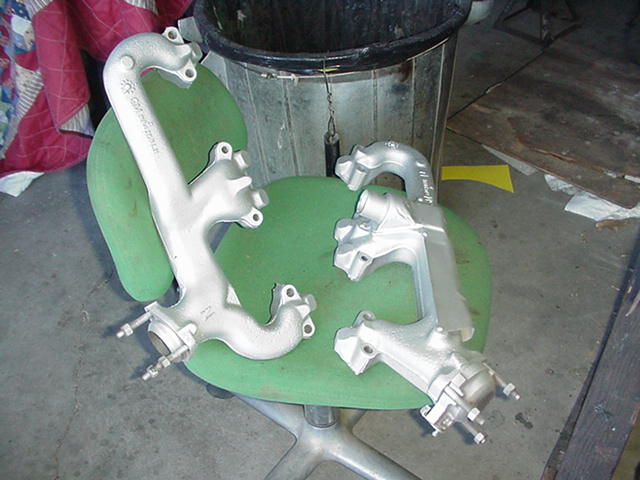

Yes, for the truck air cleaner I used the Dupli-Color Chevrolet Orange DE 1620 Engine Enamel Ceramic which I baked for an hour or so at 200o's. I also did the same w/the other orange parts on the engine. I also used a similar product made by VHT on my truck exhaust manifolds. I'll try to enclose a pic of them. It's: VHT (Very High Temperature) FLAME PROOF (Header Paint Silica*Ceramic Coating). You bake it at 250oF for 30 minutes-cool it for 30 minutes; then bake at 400oF for 30 minutes-cool for 30 minutes: and last bake at 600oF for 30 minutes-cool for 30 minutes. There are instructions for curing the paint w/the headers on the engine using the engine temp also. I think they have other colors for the header paint available. John

Gee John, maybe I'm better off with this rattle can paint then trying to get set up for powder coating. Dupli-Color Engine Enamel Ceramic is not tough to get around here, I say that because I'm sure I have some at home I've used on the hot rod headers and for stuff on the old merc on my old speedboat. I'll take a look around for the VHT you mention, that's sounds interesting too. And another thing - Dupli Color does have white in the Ceramic Engine Enamel. At least they show it online. Not sure if I'm going to do the jag IRS in white again though. Gotta give this stuff some thought...

Yes, I used the Dupli-Color Chevrolet Orange DE1620 ENGINE ENAMEL Ceramic for the air cleaner and all the other orange parts on the engine. I always bake them at 200o's for an hour or so. I'll also mention another similar product that I used on my exhaust manifolds which I will try to show a pic of after I baked them in the oven. It's a VHT (Very High Temperature) FLAME PROOF (Header Paint -Silica*Ceramic Coating). You bake it at 250oF for 30 min. & cool it for 30 min.; then bake it again at 400oF for 30 min. & cool it for 30 min.: and last you bake it at 600oF for 30 min. If you coat the headers and put them on the engine there are instructions for using the engine exhaust heat to cure them on the car. Here's a pic (I hope this time) of my truck cast iron manifolds. John

Looks like my shop oven is finally gonna come in handy John. That has been sitting out in the portable garage with the 23t, and both of them are moving into the house garage real soon! I wired a plug for the oven years ago in the garage and never used it, though I don't know if it goes to 600 degrees.
