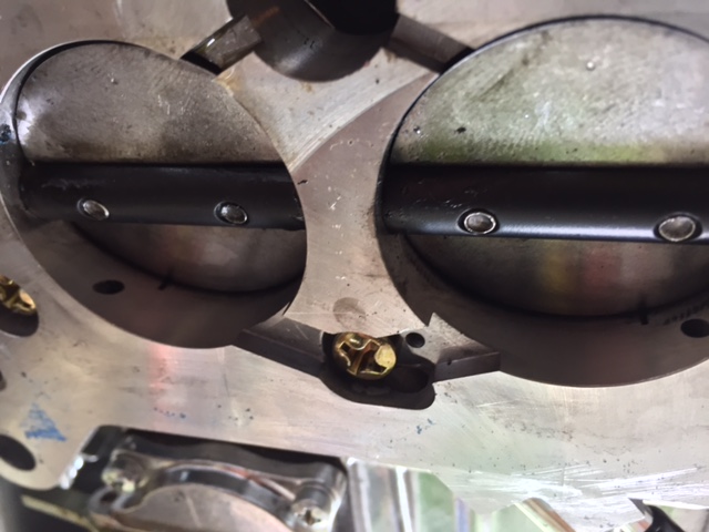

I found a vacuum leak at the rear of the carb so off it came and I took the time to check the transition slot as you suggested.
Here's a pic of mine.
Obviously I have some adjustments to do.
- transition.JPG (90.53 KiB) Viewed 353 times

(1) Is your distributor vacuum advance connected to Ported Vacuum or Manifold Vacuum. The latter will give you a faster idle and so doing may solve your problem with the transition slots being open too far. BTW, I don't find where the QuickSlayer comes in a 650 CFM version. I was looking for the baseline settings for your carburetor, like the specs below for the 750 CFM Slayer.dwleo wrote: ↑Wed Jun 14, 2017 5:20 pm OK. Here is the progress from yesterday and this morning:
(1) I re-lashed the valves (some small errors); affirmed TDC; replaced plugs; checked dist. pointer for #1 (out a tooth); set timing 12-15 deg btdc; raised idle to 900-1000rpm; checked mixture; checked vacuum 14.5 and steady .
Now it starts easy but runs slightly rough like it was missing almost (might be the cam) and rocks 1/4 to 1/2 inch when idling. When put in gear it bogs down to 750-800 rpm and does not sound happy. But step on gas (brakes on) and it perks up. Might have to up the idle some more. As my ex-father-in-law used to say "listen to the pipes for 'mommydaddymommydaddy'mommydaddymommydaddy'mommydaddymommydaddy' and that is definitely there.
Just going to take it out for a run and see how it all plays together.
To be continued later.
(2) OK. Back from run. Odd backfire drivers side pipes and a lot both pipes while warming up. Choke problem I assume. It's hesitant to drop down in gears approaching a stop and starts to bog down and I have to tap the gas to recover. Also slight hesitation while driving and I add more gas but it does recover.
Thoughts?
