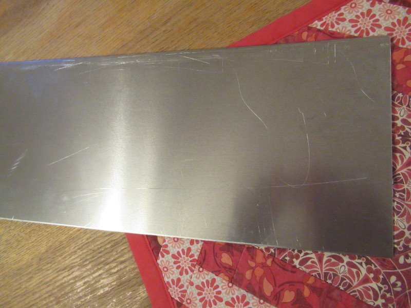

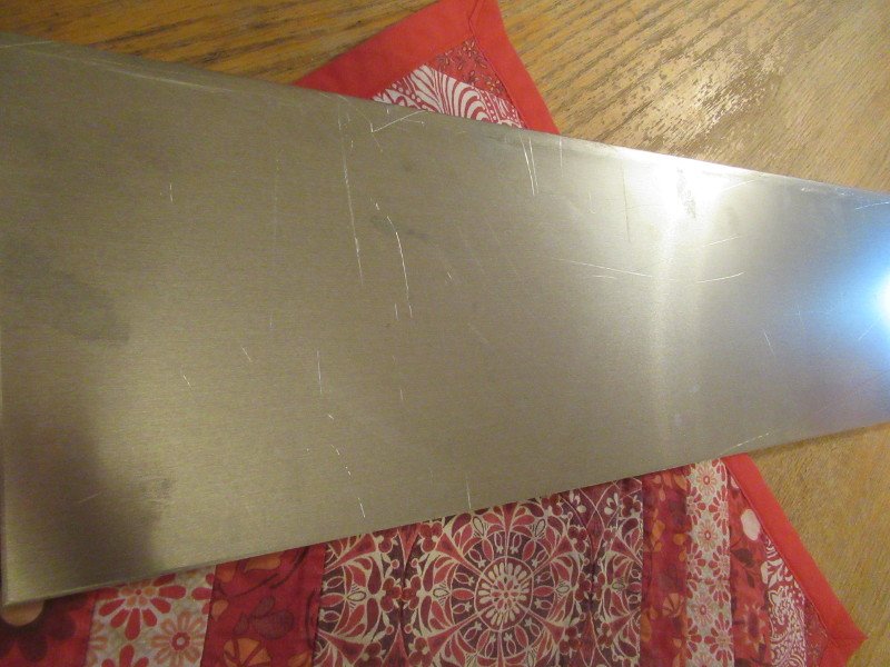

Might not make a jig, unless over the next 4 days I can figure out how to do that with my big drill press. Will make light pencil lines on the aluminum to mark off a grid. First though, wouldn't I be better off with shiny aluminum? I could start with 400 on my DA to get out minor surface scratches, then go progressively to 2000 and polish. Or is that too much work for a dash? Here's some pics of the piece I got. It has some surface scratches on it, no gouges:
Re: Removable dash?
Frank you will never see those minor scratches after the thing is turned. I did not want a shiny surface so I used the Alum just like you have right there....I think you are over thinking this think..... :)! :)! :)! :)! :)!

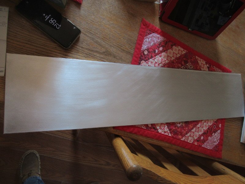

Well, I couldn't live with my picky self if I didn't clean it up a bit. So I started with 120 on my DA, went to 280, then switched to sanding pad with 320 dry, then 320 wet. I eliminated any scratches. Took less than an hour to do.
Cratex stick should be here today. Gonna pencil line a grid (1/2 inch, 3/8 inch?) on this aluminum and get at it when I can. Still got a bunch of things to do around the house. :(
Will keep y'all posted.

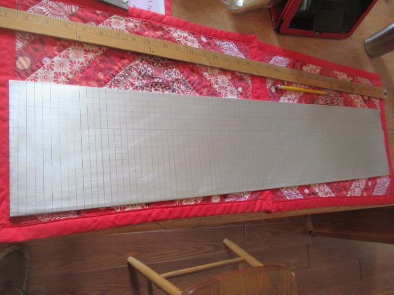

Grid lines drawn, 3/8 with #2 pencil...
