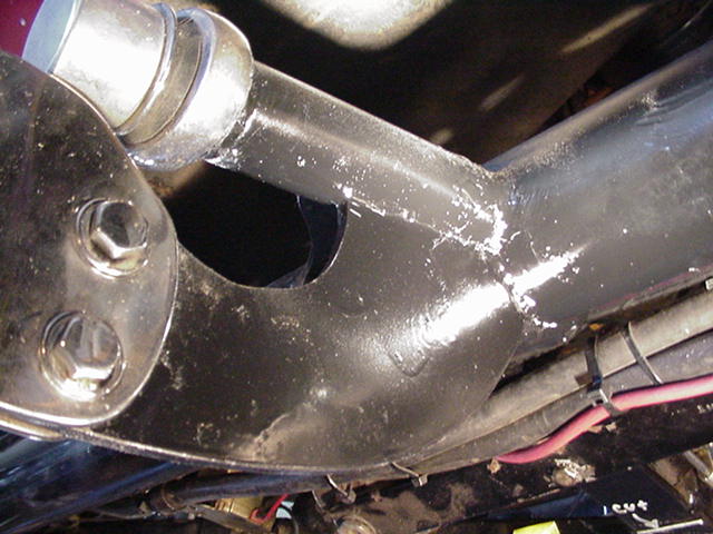

Here's 2 pics of the black frame repair. This first on looks like h*ll, but I'll have to wait for a future tear down to make it pretty. This was all overhead & liked to have killed me trying to stay steady. Finally ended up sitting on a stool & putting a 2x4 in to lean on w/no room for my helment/or leather one either.
