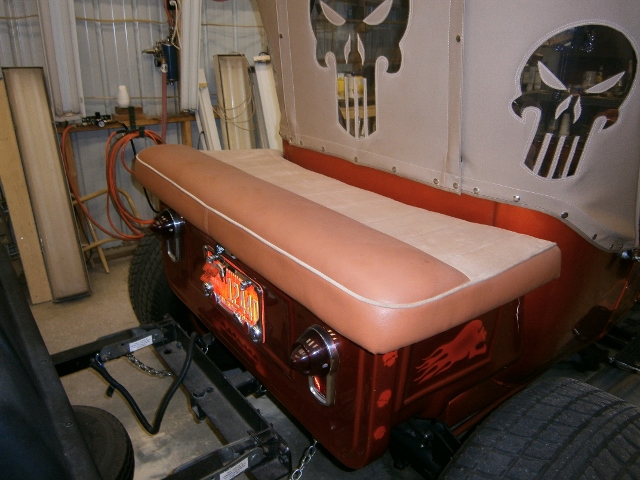

I built a cover out of plywood then mounted it on sliding drawer rollers from Lowes ....attached a keyed toolbox type latch...then covered it to match the interior......
SparkPlug..Sun-Ts...Prez
- Dewey Burton
- Posts: 334
- Joined: Tue Jul 10, 2012 6:12 pm
- Handle: SparkPlug
Re: Hard Rear Cover Advice Needed
Lets see if I can upload these pics ..... you will have to click on them to make them bigger ..... as you can see the drawer slides are mounted to the top of the bed on wood rails and to the cover ....you just slide them together... the lock keeps the cover in and secure ...I hope this helps , everyone does them a little differently ....
