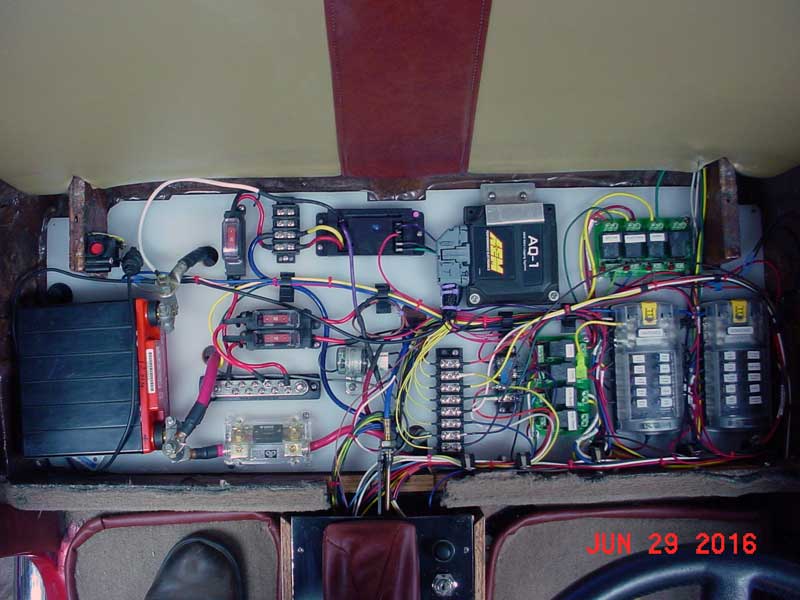

I think Rick has a chart for everything. He needs to post a picture of his wiring under his seat.
Re: Alternator Wire Size
jesse albright wrote:I think Rick has a chart for everything. He needs to post a picture of his wiring under his seat.
I have to do my research before any project, now don't I !!! :D
Will take some pics tonight and post them soon.
Good to see you posting on the forum Jesse, keep it up!
Per Jesse's request, here are 3 pics of my wiring.
Notice how small the battery is, it's an Odyssey PC-680. Laying on it' side, it's
less than 3 inches tall.
