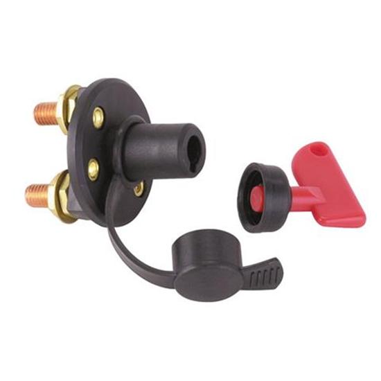

Most of the guys in St Louis use one of these battery shut-off switches, including yours truly. For some reason, even though there is no visible draw on my system, the current leaks out somewhere. The cutoff switch solves the problem! (Plus, it's a security feature!)

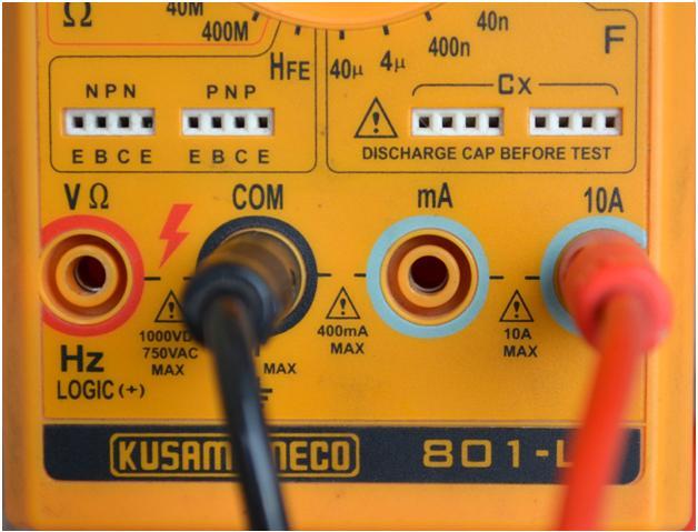

First setup the meter to measure current[10A], similar to the photo below. If you measure near zero amps, then move the RED cable to the "mA" port for a more sensitive measurement. Your meter maybe different, so pay attention and don't damage the meter.

[attachment=0]MultimeterProbesSetForCurrent.JPG[/attachment]

I tested the draw on the battery per Rick's great directions. It showed a draw of .01 amps on the first try. After going inside to warm up, the second test showed "-0.00", and this reading repeated several more times. When it read this, I flipped to a finer scale and the meter read 0.00.
Any additional thoughts?

Bill Cleveland wrote:Most of the guys in St Louis use one of these battery shut-off switches, including yours truly. For some reason, even though there is no visible draw on my system, the current leaks out somewhere. The cutoff switch solves the problem! (Plus, it's a security feature!)
Bill,
Do you put these switches on the plus side or the negative side of the battery?
Thanks
