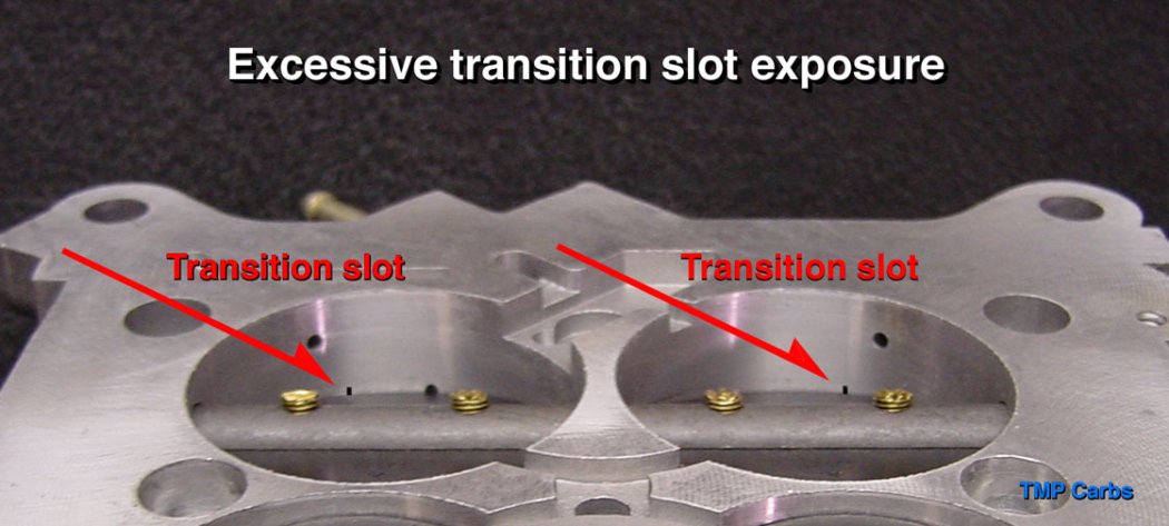

Is the transition slot adjusted correctly? If it’s not correct, then you will be
chasing the wrong problem. Many times with a more radical camshaft the idle
has to be set higher for the engine to idle without dying, but then the transition
slot is open too far. You will have to pull the carburetor off to check this
adjustment, since it’s viewed from the bottom side.
http://tmpcarbs.blogspot.com/p/blog-page.html

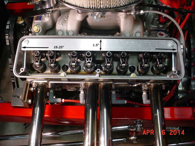

Many people like to twist the pushrod to determine valve train setup before starting
the engine the first time. Then a short time later after the engine is broke-in, they
come back and adjust the valves with the engine running and hot. It can be messy

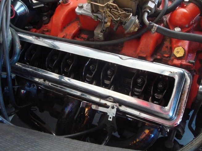

when it throws oil on the headers. They do make a clip to go over the end of the
rocker arm to keep the oil from squirting out. Some cut-up an old valve cover to keep
the oil in.
https://www.summitracing.com/parts/mrg- ... oCVsvw_wcB
Since I had a two piece valve cover I made a shield from flat bar aluminum that covered the
push rod end of the rocker arm.
