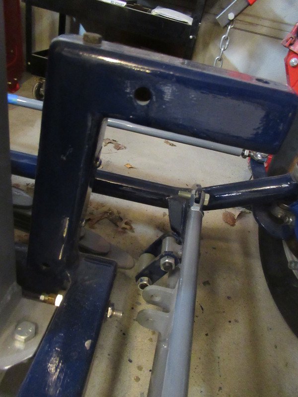

I have shock mounts on the front of my t tub from the headlight mounts (those right angle things on the front of the frame) to brackets on my radius rods. Just like I had on my old t bucket.
What I'm trying to figure out this time around is how I figure compressed length and extended length? I know the length at rest, as that is easy.
Any help greatly appreciated. Thanks!

I'm not sure where I read it, but you should allow 2/3 of the travel for jounce (upward motion) and 1/3 for rebound (downward motion).

Let me see if I got this straight Spanky. Center of hole to center of hole for my shocks is a tad over 12 inches, but with a bit of angle. So I want 20 inches of extension and 4 inches of compression?

I believe you are overthinking this, Frank. Either of these should work for your ride height . . .

My static height is actually (center to center) 12.5 inches, so I guess I'm looking at the $113 each Bilsteins if I want chrome. On the other hand, I am trying to stay away from chrome, so will do a bit more checking for something I could paint the color of the body (and fan shroud, air cleaner and headlights). Thanks Spanky. I will keep you posted pal.
