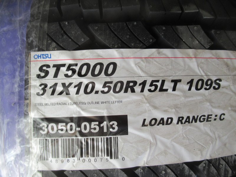

Jerry, my old 18 and 1/2 tires were on 15 inch wide wheels. My tires guy thought 8 inch wide wheels would work fine, so I went with a guy that's been in business 30 years for his advice.
I got the tires today after just ordering them from Amazon yesterday! Wheels are coming from eBay, "estimated delivery February 14-18. We'll see how that goes.
I'm gonna try a paste in a couple pics of these babies, but usually don't have much luck doing two or more in one post. We'll see how this goes...
First a comparison to the junkyard wheels and tires I have on now:
- reartires.JPG (129.78 KiB) Viewed 640 times
