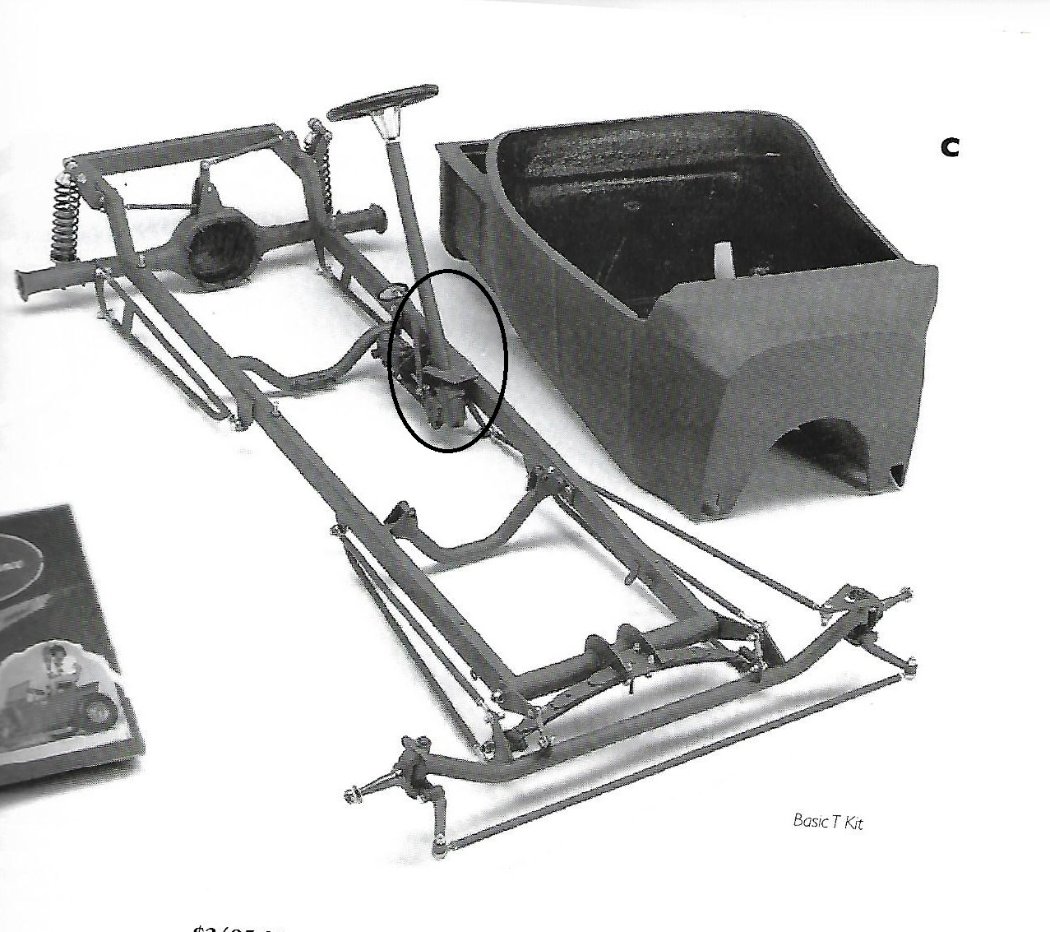

Curious, it appears that you would not be able to remove the steering box by un bolting it and dropping it out from the chassis mount. My Total Performance has a hole in the floor that appears to be just big enuf to pull the box up thru the hole. Any input is appreciated.

I think you are right. Total put their steering boxes on a bracket under the floor, right in front of the brake master cylinder, and I don't think there was access to it from under the car.
- Total steering box.jpg (152.12 KiB) Viewed 556 times

I believe the same, there is no way to get the box out from dropping out the bottom.
