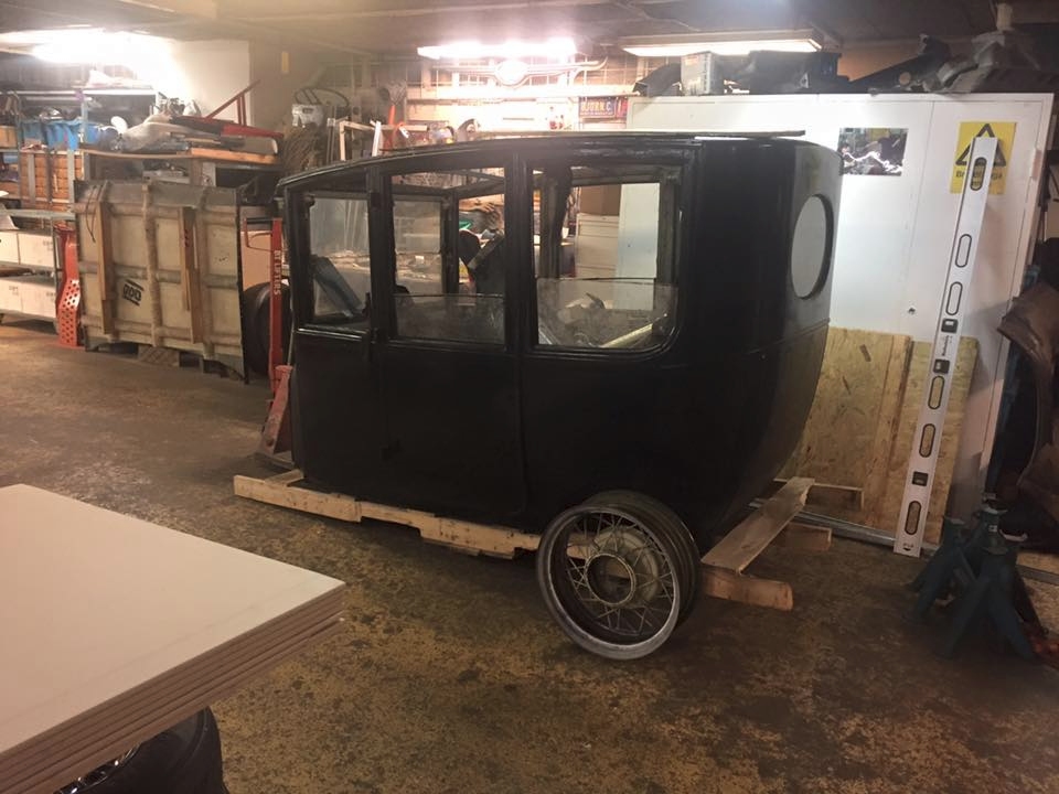

Do we have any member or members that have a center door T Bucket?? I saw one the other day and was really impressed with the look.
Posts: 5234
Re: Getting ready for Indy . . .
I don't understand the concept of "center door" . . . center of what??? :roll: :geek: :?:

We do have an NTBA member that has a center door T... Oli from Sweden!!
