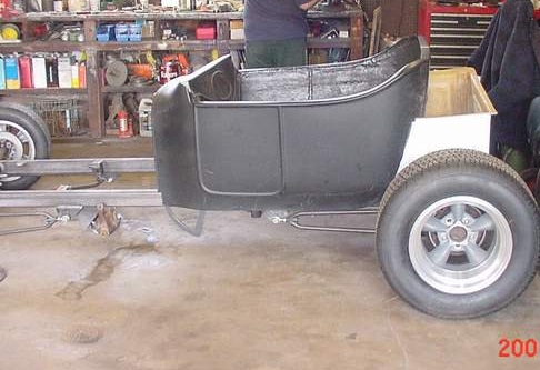

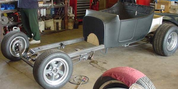

Starting from scratch . . .
Shock towers in place & welded . . . 8-) - - 'Dummy' engine in frame.
Re-locating steering box on frame . . . :roll:
And welded . . . :)!
Making progress ! :D

danger, danger... the top pic shows only 3 bolts holding the spring on.. u need 4.. and when your done with the build i sure hope u paint the orange clamp to match the frame color.. black clamp looks ok.. but if your gonna paint the car green, then stop now. we're only allowed one and the lugster has that one taken.. ok now how can i help someone else ????

You know there always has to be a critic.....the vertical weld on the box mount looks like it was awfully cold [no penetration] & where does your rad. go now ??

I am not much of a welder (obviously) but I hope the welds will hold up! I wish Bill Darr lived next door! :? The radiator will be a chopped deuce shell like the picture below, and there seems to be room to fab a mount between the steering box and the front crossmember. :roll:

Grind that weld out ,turn up the heat & try again !!

I think I'd move the steering box ahead enough to get the rad in....closer to the motor looks [&works] better.
