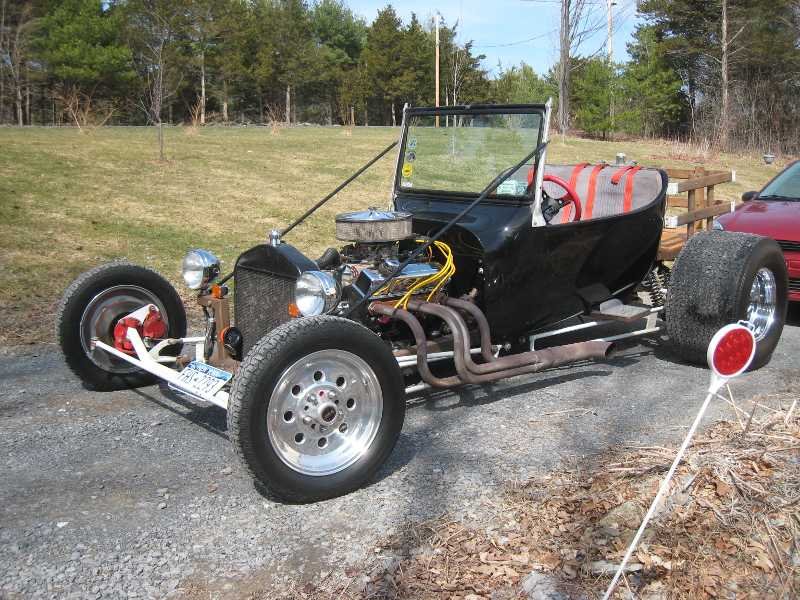

This was my old hot rod with 15 X 15 wheels. I'm almost sure they were 5.5 inch back space, but I sold them a long time ago, so no clue.

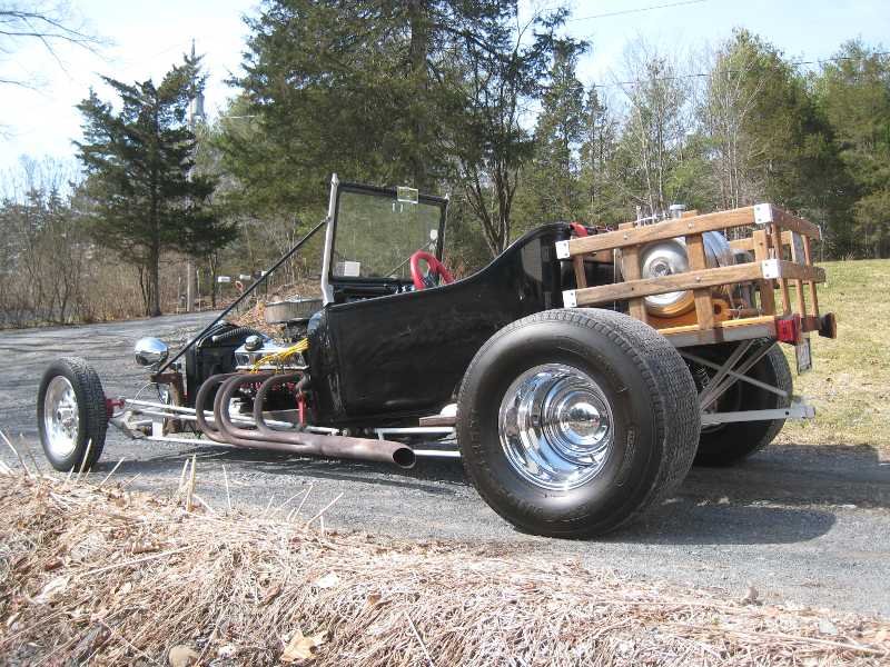

Another view

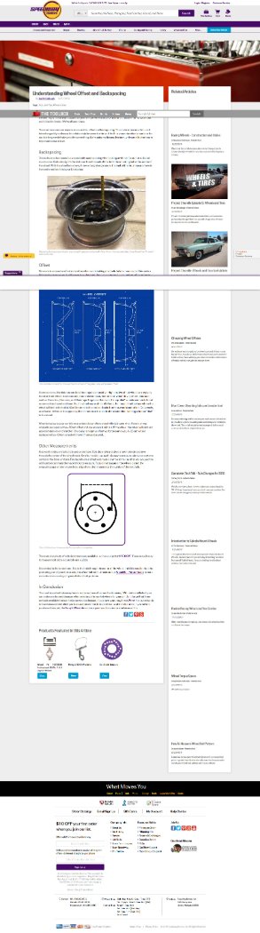

Screenshot-2019-5-6 Understanding Wheel Offset and Backspacing.jpg (58.41 KiB) Viewed 477 times
