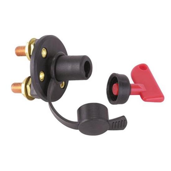

I doubt that's the problem; I'm guessing a small current leak when the ignition is off. I solved a similar situation with a battery cutoff switch. Works like a charm! Also, when my bucket is going to be idle for awhile, I put a trickle battery charger on it. :)
batt switch.jpg (16.23 KiB) Viewed 1238 times

Bill, I do have a cut off switch, but since I drive it all the time I only use it when working on the electric system.

Mine is right behind the passenger seat, and I switch it off whenever I park the bucket. :?
